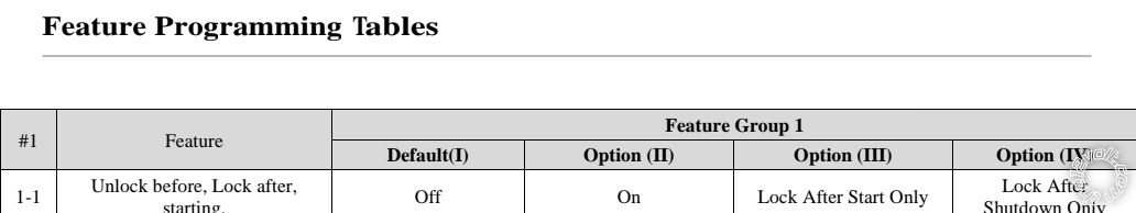

For option 28, it seems to be part of the special option group, which can only be programmed with the programmer. It's only $150 CAD, so I think it will be worth it :)
https://fti.myfirstech.com/wp-content/uploads/2019/09/CM900S-AS_Full_Install_v1.15-2019.pdf

This is really weird. I programmed the unlock/lock option. However if I remote start it, it unlocks, starts, but doesnt lock...hmmmm
