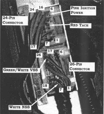

NowYaKnow
Gold - Posts: 1,217
Joined: December 18, 2002
Posted: October 24, 2004 at 11:04 PM / IP Logged
"I'm hoping that the instructions are more detailed, and that the install will look more "factory"."
Good choice getting the rostra aveo specific cruise. It should come with installation instructions (12 pages)for the aveo. Has a ton of pics as well. I've installed a handful of them and they aren't too bad. Requires a little bit of disassembly under the hood, (remove battery, etc nothing major) If your car is automatic, you have to hookup the neutral safety wire, and the VSS wire. If your car is manual you have to hookup the tach wire, and the VSS wire. They are located at the computer inside the vehicle @ the drivers underdash. Probably the one of the easiest to find VSS wires around. Here's a quick picture from the install instructions to give you an idea:
2004 chev aveo, cruise install - Last Post -- posted image.
Good luck let me know if you run into any problems or have any questions.
