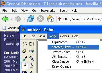

Maxst
Silver - Posts: 866
Joined: June 06, 2003
Posted: March 24, 2005 at 1:57 PM / IP Logged
open it up in paint, then go to image...then stretch/skew..
then like try 50% on both or down to 35% i just sized this to show you...

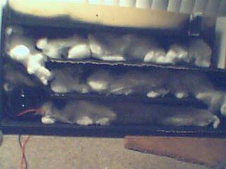

Think I did it, This is a cut-away view of the box. Its 6.75" deep, 2ftx4ft, internal port volumn equaled 2cf. I filled with poly fill till' it sounded right (alot of prying and nailing the front panel back and forth)

wheres the driver?

Lower left hand corner, covered with fill

Nice job, oonikfraleyoo.  It doesn't look like you tapered your line though.  This will cause boominess and your tuning frequency to be off.

Posted: March 26, 2005 at 12:58 PM / IP Logged
Yea I noticed it to be a litle boomy, but its actually still a very accurate design. That was just a test box to try the whole thing out, after the 6" sub design. This weekend Iam going for a ACI 10" and also a 12" Magnum Spl driver I sold to a friend. The 10" will be tuned around 24hz, and the 12" sub about 35hz. And these boxes will be  alot smaller than that 8" enclosure ( wich again, was just a tower sub enclosure)
