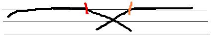

Picture a crossover setting to look something like this:
Using Test Tones or SineSweep - Last Post -- posted image.
...where the red line would indicate about 75Hz and the orange would be about 85Hz.  The crossover setting of 80Hz is in the middle and will be played by both the sub and the mid driver so that it's volume is relatively just as loud as either freq to its left and right.  The straight lines would represent amplitude, or volume.  This is the picture you're making when you set those xover points.
Do the same thing with the HP, but in reverse.  There I'll be looking for 85 and 90 Hz to sound the same volume but both be louder than 80Hz.  After that, it's a matter of tweaking slightly while listening to a good song track with prominent drums.  I want to feel the kick of the drums in the front and i'll know I have the HP crossover right.  At the same time you don't want to know the sub bass is coming from behind you.  Good (and plenty of) damping in the doors or wherever your front midbass drivers are will help greatly with the front bass response.  That damping even helps bring the actual sub bass forward even though the front speakers are attenuated at those low freqs.

Oh Stevdart, I actually was picturing spotlights (like the ones on Stage )as a crossover model :) great drawing ;)
