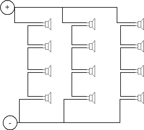

I still dont get how to physically wire them. I need visualization, thankyou

Posted: July 25, 2005 at 5:09 PM / IP Logged
Here's one suggestion (net 5.3-ohm load if all speakers are 4-ohms:)
