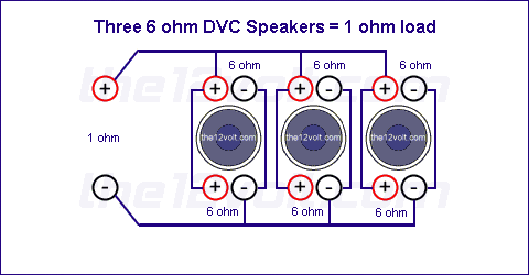

Perhaps Steve was not quite awake this morning when he posted. I know I am still doing the morning squint right now. In every case a 3 subs system does not need to be wired to a 2 channel amp that is bridged. I could also take the subs are wire them in parallel to a 2 channel amp in stereo as well (and done before successfully with them still playing today). It is about the load that the amp sees from the subs.
Option 1 (parallel/parallel) = 1 ohm load
Voice coils wired in parallel, speakers wired in parallel
Recommended Amplifier: Stable at 1 ohm mono
wiring 3 subs - Last Post -- posted image.

The problem there would be is sony doesn't have a 1 ohm amp(we'll atleast not one that powerful)

Rob, I'm still wide awake  wiring 3 subs - Last Post -- posted image.  But I can't envision any configuration of three of the same sub, and with the proper purpose of giving an equal amount of power to each of the three subs and to each coil, where splitting them to two channels will benefit you over bridging the load in its entirety.  SVCs are ruled out as there is an uneven number of coils.  That leaves DVCs, in which we could look at DVCs 2, 4 and 6 ohm.
I don't see a case among any of those three where splitting coils to separate channels gives you a safe load on the amp that you couldn't achieve by bridging the subs wired among themselves according to the diagrams.  And/or,  you could achieve the lower safe load by bridging.  And given that "safe load" is 4 ohms minimum bridged load and 2 ohm minimum stereo load as this thread refers to.
Or are you saying that you can, in some of these scenarios, equal the load on the amp by doing all this splitting of coils and wiring in stereo (thus bridging isn't necessary)?  Or that you could put a lighter, higher impedance load on the amp because of power restrictions?
So I should never say "never", or "in every case".  But certainly in this case, as I indicated that it didn't matter which coil configuration subs he had for what I said to be true.

I was drawing the generalization in the post Steve. Reading the thread as a noob, I read it as it cannot be done, when indeed it can\ if the circumstances warrant.  As it pertains to this thread, you are correct. As it pertains in general, the pic is there to show someone that it can be done.
