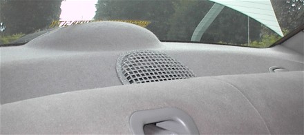

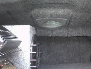

Here's a way (as I trot this old pic out again).  In this instance I used the OEM sub speaker cutout, which is a 6 X 9 hole in the center of the parcel shelf, as the passthru.  To keep sub waves from interfering with the rear mids, I fashioned a "tube" out of flexible vent and speaker hats.  On the inside, a standard grille covers up the opening and is painted to match interior.  (Rears are hidden under OEM carpet).  You can make a passthru in a variety of ways...use your imagination.
