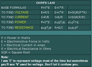

    4.  There is more output at the lower (2 ohm) impedance load.  Basic Ohm's Law:  voltage = current X resistance, and power = current X voltage.  A specific variation on these base formulae, as an answer to your question, is this one:  P = E^2/R, or Power = Voltage squared divided by impedance.
    Keep in mind that output is rated per channel.  A mono amp is one channel, a two-channel amp is rated per each channel.  Bridging a two-channel amp is splitting the impedance load across both channels.  That's why you'll see ratings for bridged output equal to the two channels at half the impedance each.  BTW, if those specs you listed were referring to a mono amp, it is an error to use the term "bridged".  Instead, they could have correctly said, "Using both sets of amplifier output terminals into 4 ohms".  The reason is that this amp has dual terminal sets for convenience, which you may use or not.  Using both of them parallels the connecting wires so that a 4 ohm load becomes 2 ohm.  In most cases, the wiring is done on the subs themselves instead, and only one set of terminals is used.
