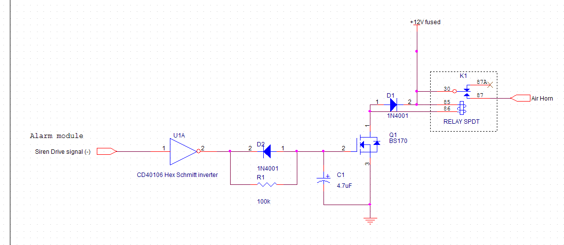

If you use that configuration, you might consider using a transistor instead of a relay for inverting the signal polarity, otherwise it's going to result in a high standby current from the relay coil being energized whenever the alarm is armed.
You generally want to avoid having standard relays energized in the standby mode, to avoid draining the battery when left parked for extended periods-

Could try something like this-
Instead of using the Gnd while armed signal to gate out the pulses while arming or disarming, this would put a delay on the trigger so that the relay doesn't kick in for short pulses of the siren (-) output. You might experiment with the values of R1 and C1 depending on how long your arming pulses are. Add your flasher to the output of the relay to have it pulse.
How do i add airhorns with (-) output - Last Post -- posted image.
There's probably some easier way to do all this from some feature of your alarm, but if not, you could give this a try-
