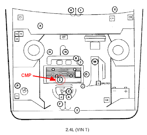

Guaranteed best tach source for 2.4L : CMP Camshaft Position Sensor. It's a BROWN / WHITE in a 3-pin plug.
1998 pontiac grand am tach wire location - Last Post -- posted image.

Big Dog......thats cool......really cool. Where did you get the diagram?

I have Mitchell 1998 pontiac grand am tach wire location - Last Post -- posted image.
I've ALWAYS used CMP in GM's and it's BROWN / white 99% of the time. Especially in GM full size trucks - stay away from the white. CMP is great in Sebrings and Intrepids and works wonders in some FORDs which they call the SPOUT, an acronym for SPark OUTput.
