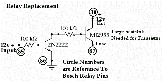

hotwaterwizard
Silver - Posts: 1,350
Joined: December 11, 2003
Posted: January 02, 2008 at 8:10 PM / IP Logged
For a small load like an LED you could use a 2N3906 instead of the MJ2955. Donit forget t6he Resistor on the LED

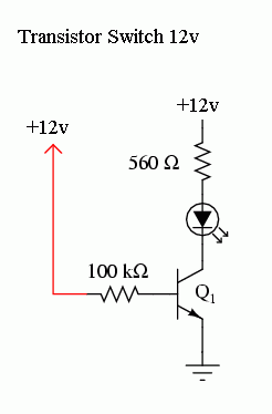

hotwaterwizard
Posted: January 02, 2008 at 8:16 PM / IP Logged
Oh Duuu Here is a circuit that uses only one Transistor.
Use 2N2222 Transistor.
switching leds with relay on sensor wire -- posted image.
John DeRosa (Hotwaterwizard)
Stockton California
When in doubt, try it out !
KPierson
Platinum - Posts: 3,527
Joined: April 14, 2005
Location: Ohio, United States
Posted: January 02, 2008 at 9:00 PM / IP Logged
^^^ That base resistor (100Kohms) is a bit high for my liking.  With a beta of 100 the transistor will not be able to outut enough current to run the resistor at the specified value (21.4mA).  With a beta of 100,  the transistor will only be able to output a total of 12mA.
I would recomend a base resistor of 10K.  This will pull, at most, 1.2mA of current from the signal - a neglible amount.  However, with the 1.2mA and a 75 beta (more likely what you'll get with the 2N2222 in this voltage/current range) you'll see a max of 90mA on the output - more then enough to run the LED at 21.4mA.
The important thing here to consider, though, is the current requirement of the LED you choose to use.  This could effect the collector resistor value (560 ohms) which in turn could effect the base resistor.
