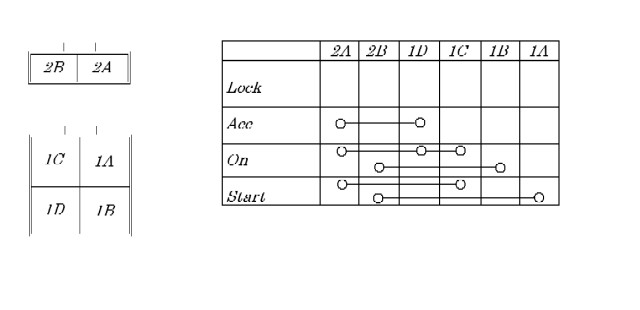

OK... Ifind this picture at Mazda workshop manual.
If I understand it right, I should have two wires with +12v at start position, but I cant find any.
