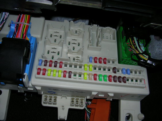

After leaving the car for 12-20 hours I noticed it was sluggish to turn over...so I hooked up a multimeter in series with the battery. Positive cable to multimeter/ multimeter to positive post and measured the current draw that the system was pulling when the car was turned off. (Parasitic Drain) It measured to be 150mA-160mA with an initial spike of 250mA (enough that it was making a huge spark when I touched the leads to the battery).
This is far above the max recommended parasitic drain on the battery which i've read to be 50mA and specifically 35mA on my car. (A Mazda 3 2006).
The image bellow shows what I have finally identified as the source of the problem. The Large Green Harness shown in the upper right corner of the fuse box is where the problem originates.
dead battery overnight audio system? - Page 2 -- posted image.
When I unplug the green harness the amperage draw stops.
I pulled all of the fuses in the engine and in this under the dash fuse box. None of them stopped the amperage drain. Do all of the wires in the Large Green Harness go through a fuse in this box? IF so, then there has to be a problem with either the green harness or the fuse box itself. (Since I've pulled all of the fuses and none of them solved the problem).
Does anyone have ideas on how I could test each wire. And more importantly, does anyone have information on which wire is which? It's labeled "Front-1"
Thanks!
