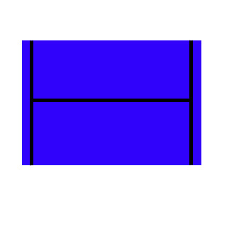

I ask because there are 100 and 1 solutions to this. It all depends on what you are working on. If you are covering an MDF box then I suggest you cut an H pattern on one side of the box with a table saw or with a skill saw. Simply set your saw to cut ¼” deep. When you cover your box stretch your carpet around the box and tuck the carpet into the grooves. Once you have it tucked into the groove cut with a fresh razor blade. Select carpet that is stretchy. If your carpet won’t make it around the entire box, cut grooves where ever you need them. If you do this properly it will be very difficult to detect the seems.

fleece, vinyl application -- posted image.

where do you cut when its in the groove? or do you mean, cut so it fits into the groove?
