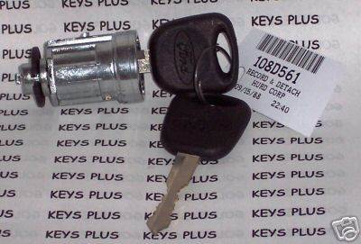

Reeceddogg
Copper - Posts: 329
Joined: September 23, 2002
Posted: January 26, 2008 at 1:28 AM / IP Logged
Key looks like this 97 contour 2 wire pats -- posted image.. I tried the 97 cent walmart key. Opened the door but won't start car.
