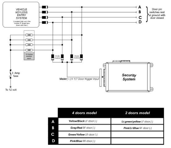

Here's how to build a 'pull-up" which will give a positive trigger output:
2006 f250 door pins -- posted image.

The diagram that I sent you for the Pontiac should also work for the Ford. It's a generic diagram that isolates the door trigger from the BCM so you don't get the RS to acknowledge the dome light trigger after shut down.

I hadn't seen Jeff's diagram but I assume he's using the BLACK/ Blue domelight in positive trigger but timer isolating it during remote start so it's isolated for a few seconds after remote start shuts down. That'll work. (would you care to upload to "downloads" section so we can take a look, Jeff?)
Your second option is my idea using a "pull-up". The individual door pins are in three seperate locations. LF is at drivers door boot. RF is passenger door boot. Rear doors are along driver's door sill plate.

Door trigger bypass for manual trans

Jeff, you hadn't had any problems with N.C. circuits drawing 12 milliamps? That's sounds like a lot for smaller batteries. GM's fail to start with more than 50 milliamps after two days.

Never had a problem with this hook up with battery drains. An additional 12 mA is small enough that it will not affect the rest of the system. Most of these vehicles come with a 550-650 CCA rated batteries and would take some time before 12 mA would cause any sort of problems.

Excellent. 2006 f250 door pins -- posted image.
