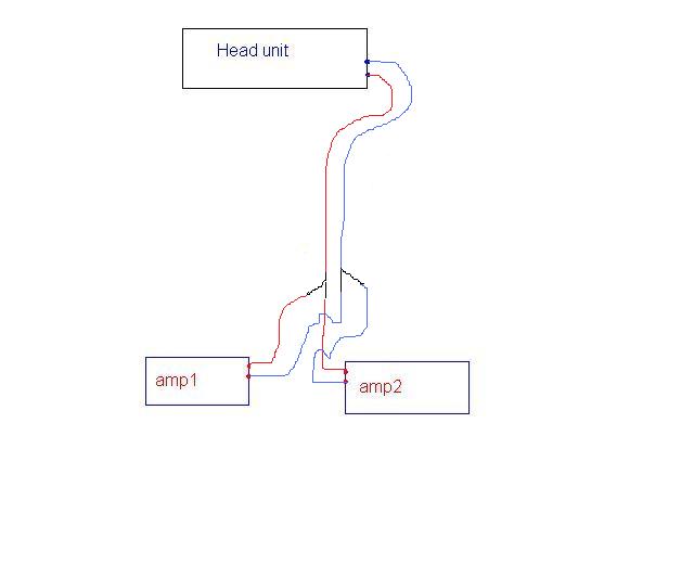

Do Y adapters make you loose any type of quality? It just confuses me. Cause your changing 1 output to 2 outputs. Can someone explain to me how this doesnt derease quality or the level that is being put out ? Cause I got 2 channel RCA's going into my amp. But I am gonna get another one of the same amp and run each sub to its own amp So I would be converting the 2channel RCA's basically to a 4 channel like this. Can someone explain if any quality or output is loss? And if so why it just gets to my head that something has to happened converting 2 to 4. Would this be an appropriate way to wire the RCA's?

Due to the fact it is a low level signal that gets amplified and the fact you are paralleling the outputs. It doesn't change the level by an amount that would be audible. The amplifiers are equipped with level adjustments so you can balance out sensitivity of inputs being used.

So that would be appropriate way to wire my amps RCA and i will still get the suffcient quality and output?

The way you have it will take right to one amp and left to other. You could get the y able the changes to two female and add a small rca with a right and left going to both amps so when it is running mono you will get them to blend right and left into each amp.
The way you have it will sound fine as well.

Yes that is the way you need to do it.

This does make some basic intuitive sense - and I actually this is a real interesting statement just from a psychological standpoint - but anyway - no - low level signals don't work like that - I can't really explain it technically - maybe heamph or DYohn can - but it isn't like water in a pipe- it doesn't have mass that is being split up so it doesn't reduce the signal or degrade it or anything.  You could daisy chain 10 amps like that and they would all recieve a useable signal.
This wouldn't work for a 4-channel/sub-amp setup, but for subwoofers this is okay - you'd lose stereo seperation if you were doing it with 4-channel.

do y adapters make you lose any quality -- posted image.
Do it like that.

Think of your head unit's pre-amps as a high quality amp and the amp they're connected to as a speaker.
You know how a good amp can double its output power when the impedance is halved?
Your HU can do the same thing, but since the pre-amps have such a low output impedance compared to the rca inptus of the amp they can be split several times (each split cuts the amps input impedance in half) w/no significant loss of voltage.
