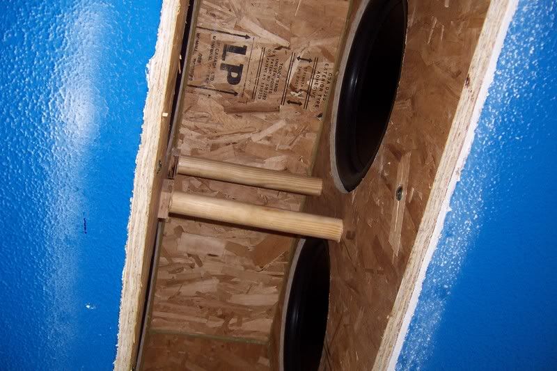

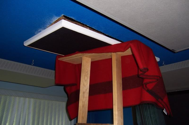

Here's what I have in moind.  Four Fi 18" speakers IB in the ceiling...
fi audio -- posted image.

Posted: March 02, 2008 at 3:47 PM / IP Logged
OMG!
Are those your pics DYohn?
What fastners are used to hold the basket against the mdf?
Would two of those woofers have polarity reversed?
Could something like that would represent some type of long term structural problems?

Inside the room looking up:
Putting the grill cloth into place:
No, they're not mine, but I designed and installed the system. The clips are modified mirror mounts, designed so the drivers can be mounted or unmounted fairly easily if necessary.   All four are in phase, at 4 ohms to a 1000 watt amp.  The baffle is 13ply Euro-birch, ODB and MDF.  Fi 18" "Q" series drivers.  No structural issues - except maybe long term.  Capable of flat response to 18Hz and over 130dbSPL.  It's great for watching movies.  fi audio -- posted image.
