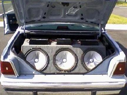

Here's my MDF project finished and carpeted.
what’s better, this or mdf? -- posted image.

Looks like particle board to me... MDF is going to be better..
