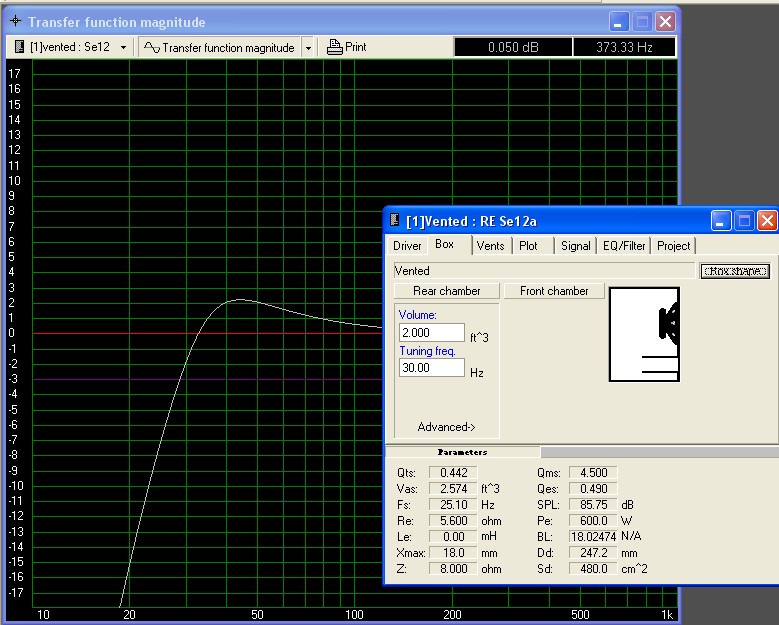

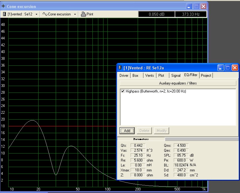

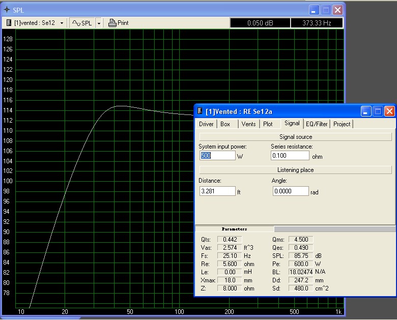

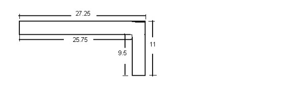

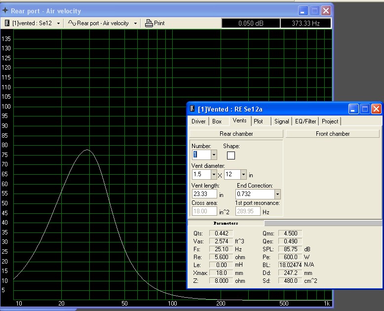

Does that look about right...the port size is 1.5x12x36.75 to get the tuning to 24.5 Hz and the graph as shown. The port velocity maxxes at around 45 fps rms or 65 fps max at 25 Hz. Also, the cone passes its max excursion at or below 20 Hz so I would use the filter that the amp has on it. Does all of these things sound about right? I drew out some plans last night for a box around 2.6 cubes, which after the port, sub, and bracing, should be right around 2...thanks for any help. Also, if you need to see any other graphs just let me know and I can throw them up here.
