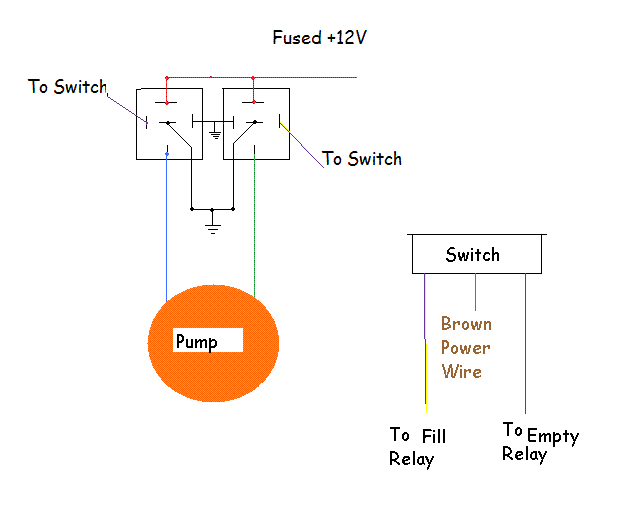

relay, need a reverse circuit. -- posted image.
This should do the trick.  As long as the time circuit is not in the power that supplies the switch.  The yellow and white wires did not show up so good, but the switch in the picture is the existing switch in the boat.    You will have to build the relays and attach the yellow and white wires from the existing switch to the relays.

Well, I just tried that and no dice. Didn't turn on the pumps at all. Any other thoughts? Does that "power" wire from the switch need to be in the mix?
Platinum - Posts: 13,726
Posted: March 29, 2008 at 8:06 PM / IP Logged
The switch is the actual switch already on your boat.  Are you sure that the brown wire going to the switch is actually power?   If the brown wire is not a positive wire then this will not work.  I am on the way out the door I will be back Monday evening.
