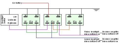

fuse blowing when reversing polarity -- posted image.
I want my headlights to automatically raise when headlights are turned on and lower when turned off.
When i test this circuit with a test light it works fine but when hooked up to the headlight actuator it blows the fuse.
I don't see what is wrong.
Is there a simpler way of doing this with fewer relays?
Thanks for your help

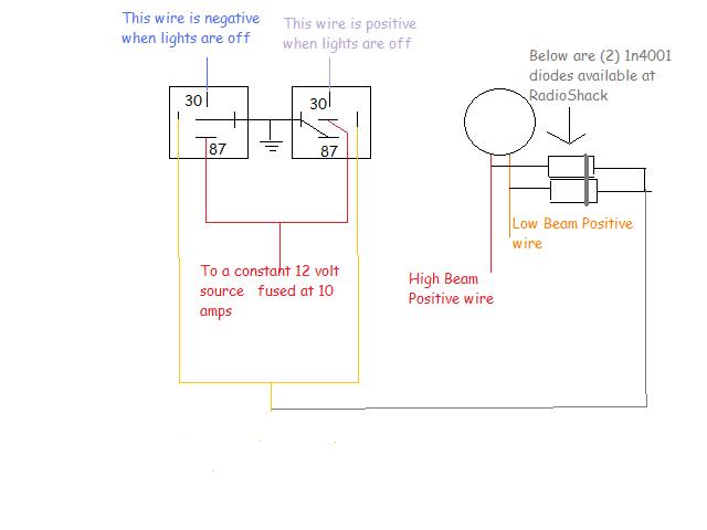

rkrosiere
Joined: April 08, 2008
Posted: April 08, 2008 at 7:58 PM / IP Logged
Thank you for this info. It took me awhile to see how it works but i think i got it.
What function do the diodes have in this circuit?
Platinum - Posts: 13,709
Posted: April 08, 2008 at 8:07 PM / IP Logged
They keep the low beams from turning the high beams on.  And vice-versa.
