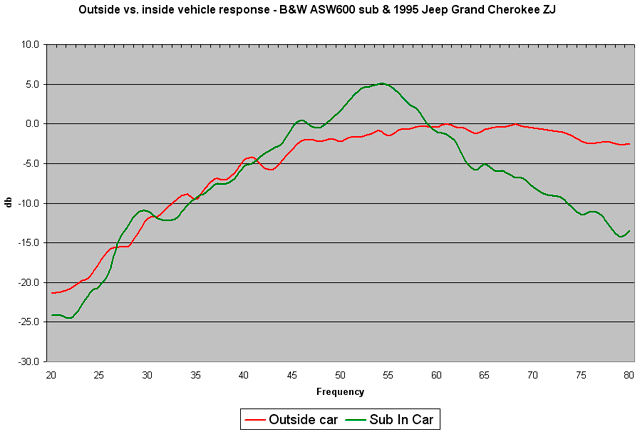

To measure how my car will affect the response of my transmission line, I needed to run a few tests. First, I placed my home theater sub (a Bowers & Wilkins ASW600) on a chair in my backyard, careful to make sure it was not near any large walls or objects that might alter the response. Then I played test tones and measured the response of the sub out in the open, which is as close as I can get to an anechoic chamber which is what all enclosure simulation and calculating software assumes. Then I repeated the test placing my ASW600 sub in my car facing rearward like I plan the transmission line to.
I used a Belar spectrum analyzer connected to the best microphone I could find for this test. It is a Sennhieser 421 which has a frequency response rated down to 30hz, the lowest I can get my hands on. This is important to remember, any values below 30hz must be accepted with a grain of salt, they are not as accurate as the higher frequencies. There is a microphone preamplifier between the Sennhieser and the Belar, which should be transparent to these tests. The mic was placed one foot in front of the woofer in my backyard, and was sitting on a small mic stand in my front seat when the sub was in my car. After many attempts both inside the car and out, waiting for the wind to die down and averaging the data over many minutes, I came up with the following two graphs.
transmission line sub -- posted image.

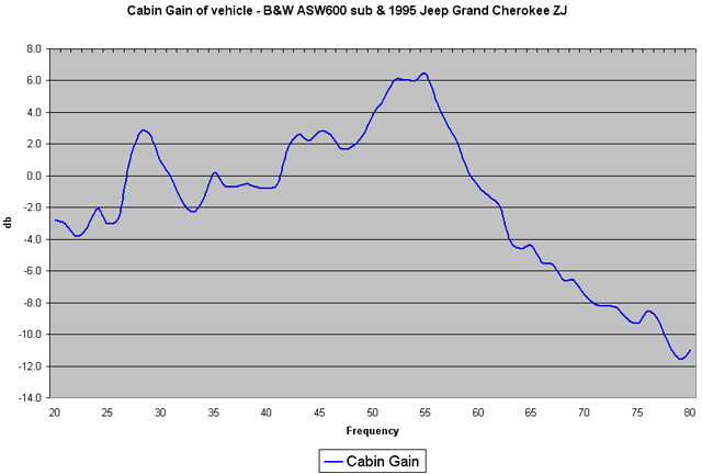

And here's the result I was looking for. This is simply the difference of the two lines in the previous graph, and it shows how my vehicle affects the frequency response of a sub.
So, what does this all mean? Looking at the first graph first, the sub placed in my backyard has a fairly gentle roll off from about 55hz and lower. When placed inside my car the response peaks sharply at about 55hz and rolls off in both directions. The data I want from this test is in the second graph. Other than a peak at 28hz, there is a rise of 8db from 20hz to 60hz. The slope from 60hz and up can be disregarded because I will have a low-pass filter on the amplifier anyhow. Good to know! Now I can keep this in mind going forward, to make sure my transmission line compliments the cabin gain of my car.

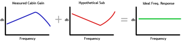

Step the second: design hypothetical subwoofer to compliment measured cabin gain
Lets start with a picture.
Or not, I'm not sure what the issue is, I can't see the picture on my preview window here. Anyhow, what I'm trying to show is the measured cabin gain, and the response of a hypothetical sub I want to build. From 20 to 60hz, the cabin gain increases by 8db. So my sub would have to decrease by 8db in order to have a flat response when installed in the car.
Having such a low frequency peak and roll off on the high side is not easy to do when building a sub, and very difficult with a sealed or vented enclosure. A bandpass might be able to, but would need a resonant frequency terribly low and the enclosure would grow huge in size. The transmission line however, can extend the response of a woofer well below it's resonant frequency, and be really efficient while doing it. Have you ever heard of a single 4" woofer achieve response down to 35hz!? It's been done, there are a few examples here and here So, expecting a response down to 20hz from a 10" woofer should be no problem, if properly designed!
On the subject of cabinet size, it has to fit in my car. I'd like to not sacrifice all of my cargo room for the box, but I know to do this properly will require a decent amount of space. The box must also be removable in case I need the cargo room. After taking measurements in the rear cargo area of my Jeep behind the back seats, I came up with the following: 34" wide, 33" deep, and as short as possible. The height of the box will be influenced mostly by the woofer choice, how large the woofer is, and the internal volume I need for the transmission line. Thus, the height will be a variable I can play with if I need more or less volume for the transmission line.
So there we have it. The hypothetical subwoofer will be 34" by 33" and some unknown height, removable, and have a frequency response that peaks around 20hz and slops downward towards 60hz. Of course it must also be production quality and look beautiful. On to the next step.
