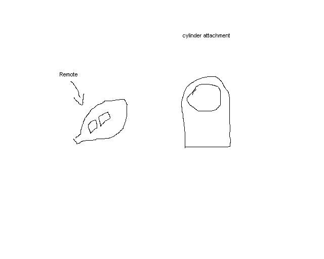

There are no wires spliced into the main harness. These wires disappear into a harness located up high in the dash. I didn't find any unit under the dash.03 chevy venture passlock lll problem -- posted image. I hope this pjcture comes out.

I think that vehicle might have had a DEI Smart Starter Kill Relay installed. Call an auto parts place and tell them you need a new relay for the starter that goes into the main fuse panel under the hood. Then check the fuse box for a diagram for where it would be in there and replace with the new one and that may solve your problem.
Those smart starter kills have a receiver built in to allow the vehicle to disable the starter or to allow it to work.

Sorry for not getting back sooner. It was the relay that techman93 said. best of all it they left it in the glove box and nobody knew what it was. So THANK YOU very much for your help. As always the help given here is always correct.
