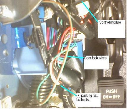

As you can see in the following photo the driver's kick/fusebox area is a good place to find many wires, as well as to mount the control module.
The fusebox assembly removes with (3) 10mm hex nuts/bolts. I mounted the remote start/keyless control module (in this case an Audiovox PRO9276, which is on the large side) to the wiring harnesses behind the fusebox and to the left of the parking brake pedal assembly. In the kick panel harnesses are the wires for lock(violet), unlock(GREEN/ black), (+) parking lights (green), and brake(blue). There is also a nice factory ground bolt in the kick which can be used, and the tach can be found at the OBD-II connector in this area.
08 tacoma remote start, random musings -- posted image.

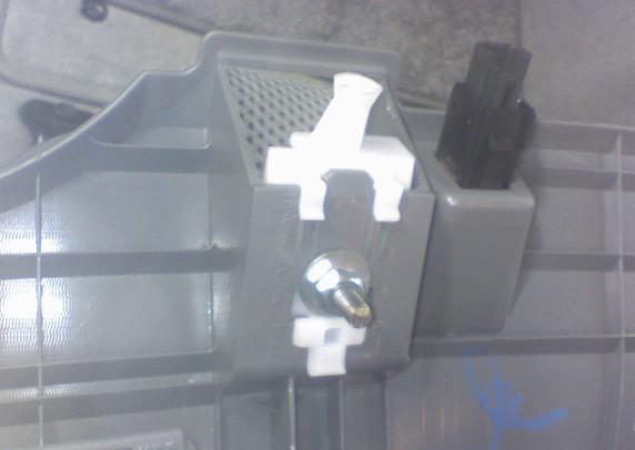

The next photo shows the hood release from the inside - obviously that's not a factory carriage bolt holding it in place! The release lever snaps in to the main underdash panel, and it's really easy to break the locking tab if you try to slide it out. I've had this problem on other Toyotas as well. Best solution is to leave it alone and just pull the cable out of it.
