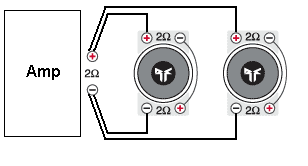

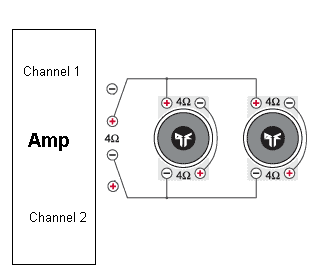

If you decide to go with them, the IMO the best match with your amp is (2) of the 4ohm p3's (P3D412), NOT the 2ohm DVC's. Your amp isn't listed as being 1ohm or 2ohm Mono stable, so by using (2) 4ohm DVC's you have 2 options (actually there are more, but only 2 suite your amp):
1) Wire each in parallel for the 2x300w@2ohm Stereo rating.
inverted subs in slot ported -- posted image.
2) Wire the subs in series/parallel for the 1x600w@4ohm Bridged rating.
Either way gives you apx. 300w per sub. Since the subs are rated at 500rms you're more than safe. Plus you would have some room for a more powerful amp in the future if you decided to upgrade that too.
