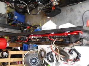

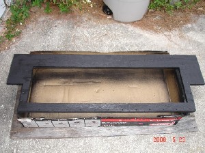

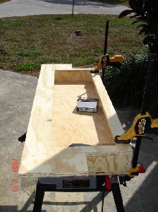

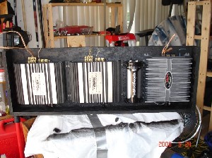

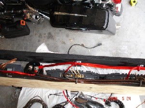

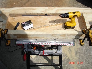

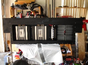

Ok, here's some pics of the amp rack. Sorry if they seem grainy, they didn't resize well and you can't fit much into 30kb lol...

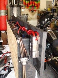

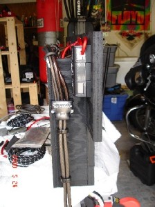

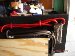

I'm running dual lengths of 4awg for power (not shown). From the fused distro they are split into one 4awg for the RF 1000bd and two 8awg feeds (one for each of the Kenwoods).
Right now my favorite touch has been the cable ties. I wanted something other than a plain plastic zip-tie, so I used the sheathing from some spare 8awg wire and ran the tie through it. Gave it a much better look.
Hopefully I'll have some more to show next weekend.
