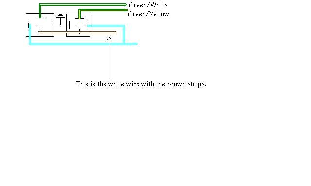

You will have to use 2 relays to replace one of these relays. The GREEN / WHITE and the GREEN/ YELLOW are connected together when the relay is energized, when the relay is at rest those 2 wires are not connected. I will draw you a picture. Might be later tonight or in the morning.

no. they are all on there own pin. i think out of the new pictures there is a decent picture of the wires going to the pins.... the one pin where there isn't a wire going in has a tab that solders to the metal case wich in turn is grounded when the relay is screwed down onto the car.

identify this relay. - Page 2 -- posted image.
The above picture will replace one of the older relays. You will have to build 2 of these.
