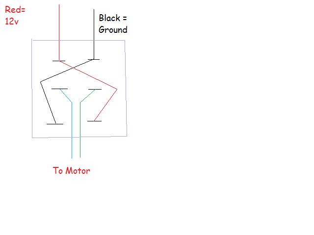

I'm curious as to why you're using relays at all? Those 59 Chevy switches aren't reversing polarity?
If they are, you should be able to directly wire the window motors from the switches.
that just crossed my mind, the old switches were on on with 6 legs each.
Platinum - Posts: 13,725
Posted: June 30, 2008 at 5:14 AM / IP Logged
power windows -- posted image.
