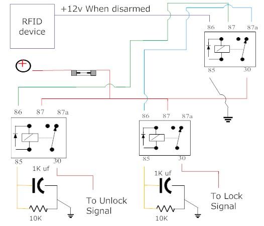

So is this basically how it would work? and what sort of a pulse would that deliver? How long? long enough to drive door locks? Can the cap or resistor be changed to change the pulse length, and what Wattage should the resistor be?
Thanks so much for your help.
Ben
P.S. I found a Demo of Smart Draw to make this drawing. Man that program is expensive.
rfid central locking. -- posted image.
