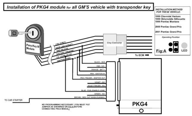

If that's the case, remove the PKG4. Follow the wires of the PKG4 to where they're connected in the car. Disconnect all the wires of the PKG4 from the car.
You will probably notice that a small pink wire was cut in the car which they connected to the wiring of the PKG4. You need to re-connect this small pink wire which was cut.
The car will now start with the key.
Here's the wiring diagram:
pkg4,need to start to program? -- posted image.
