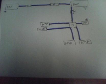

I understand everthing you said, but since I never had to do these types of installs yet or seen them fully wired up, I am trying to visualize a set up like this, is there a way u can post a type of drawing or diagram of sort, or maybe a website I can check out.
Thanx again for this valuable info.
well?
still_walkin
Silver - Posts: 644
Joined: April 18, 2007
Posted: July 23, 2008 at 12:27 AM / IP Logged
Ok for your system for example give me the number of amps batteries caps and such and ill post a pic of the diagram

here is a diagram of i got from your first post it consist   of 4 amps 2 batts 1 cap, 2 distro blocksb and 3 inline fuses. i didnt draw a diagram of the ground wires cause thats very simple all the grounds from the amps cap and battery  goto a distro block the you ground  the distro to the car. hope this helpsmultiple amp wiring -- posted image.

Thank you, thats what I thought I just needed to actually see it laid out.
So you are saying there would be a dist.block just for the ground right, so all the amps. Batt. Cap. Will share the same ground?
