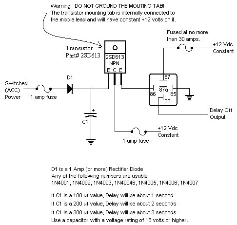

Can anyone guide me. How to make 1 pulsed generate 3 second latch? Detail how to wired to relay and whay kind of capacitor i need.

This is cheap-
1 pulse to latch 3 second -- posted image.

Look complicated...Can u advise me..how to do only use relay,capacitor,diode and resistor?

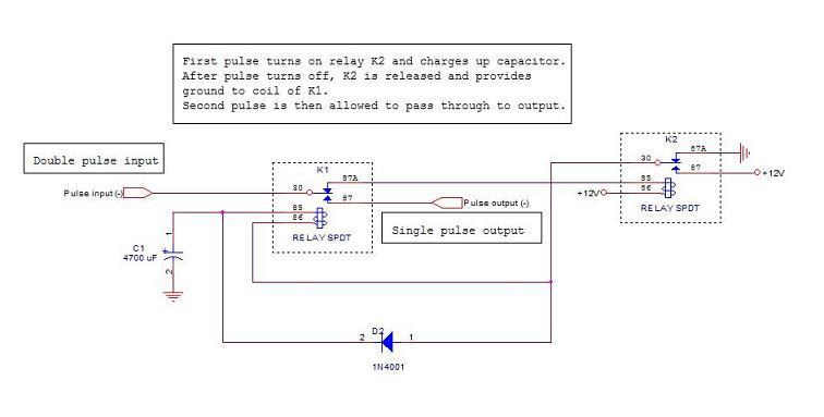

Forgot something...can u modified this diagram to be 1 puls to 3 second latch? I found it in one of the forum...it been design from you..

The other circuit is supposed to take two pulses and only pass the second pulse through, it doesn't really change the timing like you want.
If you just want a three second pulse output when you send in a short pulse, the first one would be the one to try.
If you're planning to send in a positive going pulse, then you wouldn't need the inverter chip. Just put the pulse into the diode directly.
