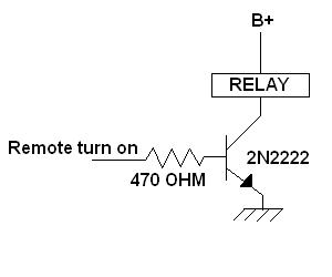

I have a VRX575USB but haven't tried what you said but you might have to use a driver like so:
clarion vs755 remote turn on issue -- posted image.

Actually, I tried pretty much the same thing and no luck. Swapped out the unit with the last one from the soundboard and lo and behold it was a unit issue....I just always blame the unit last.
