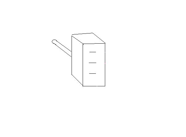

This is a picture of the back of the toggle switch.  It needs to be Single Pole Double Throw,  On-Off-On switch.
push button start in a lincoln -- posted image.

im pretty sure i understand that im just unsure of how that switch actually works
Platinum - Posts: 13,725
Posted: August 27, 2008 at 10:12 PM / IP Logged
It is an On-Off-On toggle switch. In the middle position, it is off. Flip the lever down and it is in the accessory position. Flip the lever up and it is in the Ignition position. When it is in the ignition position, the diode will also power the accessory terminal of the switch.
