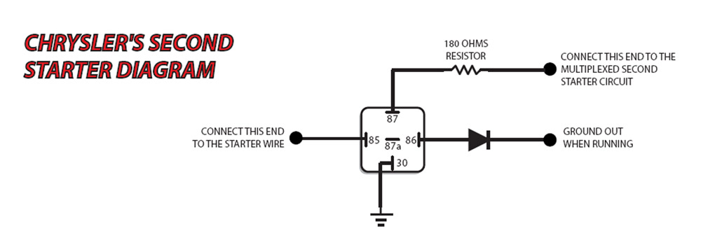

Its seem that the procedure is different from what I was originally supplied with.
With that document for the Chrysler Second Start it states to cut the PURPLE / Brown wire and attach to the 87a and 30 connectors with 87a going to a 180Ohm ground.
My originally instructions where to connect
85 to Starter wire output
86 to Ground When Running output
87  to 180Ohm resistor in series with a connection to the multiplexed second starter
87a blank
30 ground.
Which ones are correct?

Here is a picture of the original instructions that I was given.
directfax document 1083 -- posted image.
