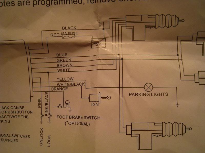

Hi,
I've got a 95 hyundai excel and I just bought a diy central locking kit with remote to fix. Everything's done except the wiring part. Could anyone shed some light on this?
I need to know how to tap out the following wires:
Red 12V -
Black 12V +
Yellow (parking lights)
WHITE/ black (ignition)
orange (foot brake switch)
thanks so much
P/s. I know they're all at the driver's kick panel. But there are so many wires there. I need to locate the few wires on top to connect.

Thanks howie, I'll try to use the meter. After I find out which wires are which, do I just cut the insulation and connect the wires from the kit to it, then wrap it up again with insulation?
It's not that I don't want to find it out by myself. I just thought that they'll be some sort of color coded diagram for the car.
megaman:
no it's not a DIY remote start. It's a central locking kit (with remote) from black widow brand. The colors were given in the simple instruction diagram that came with the kit. I'm not that good with electronics and I don't want to risk stuffing the electronics of my car. But I'm willing to learn and it would be really satisfying to be able to fix it up myself. (with a little help from forums and you guys of course)

Posted: September 29, 2008 at 9:31 AM / IP Logged
Here's the picture of the installation diagram.
Diagram
howie: here's the thing. I've been unable to find the required vehicle colors and locations. The only thing remotely similar is this site that I've found. site But I have no idea at all where's the location mentioned.

Great. I'm going to try it during the weekends. Just 1 last questions. Do I just connect my red wire to the CONSTANT (+) 12 volt wire? What about the other black wire as shown in the diagram?
Do I just ground it to any metal part of the car body?

Damn. I've found all the wires except for the parking lights. Does parking lights refer to hazard lights? blinkers? or the small little lights beside the headlight?
I've tested a lot of the wires around the driver's kick panel but still unable to locate the one for the parking lights.
