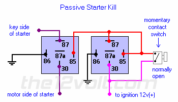

Hi
I am trying to keep my alarm on but turn my siren off with a momentary switch and then have it reset…. I need this because 1 if I had a on/off switch I would forget to turn it on 2 I need to turn it off at work… trains pass my car all day and the alarm goes off 3-4 times

Posted: October 18, 2008 at 10:27 AM / IP Logged
i was thinking of using a set up like thisalarm on siren off -- posted image.

dont know what alarm it is i will get you that info asap... yeah i will just put a switch inline but i know i will for get to turn it on and my alarm has autoarm and i am inside by time itr arms.... i know i am making things hard nowv but easy for me later on

You probably won't want to use regular mechanical relays to do this because one of the positions will have to draw power while the car is parked.
If your alarm doesn't have provisions to temporarily turn off the shock sensing, you could do it with some electronics to toggle between the two modes. Should be pretty easy if you have some experience with that.
