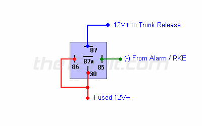

562t door locks '01 f150 -- posted image.
Is this the way I would do the domelight relay, except where it says "Trunk Release", that would be domelight.  What amp fuse should I use.
Thanks,
Troy
ckeeler
Gold - Posts: 1,461
Joined: June 20, 2008
Posted: November 05, 2008 at 8:44 AM / IP Logged
yes, exactly like that. the wire from the 562T i believe is BLACK/ white. just use a 10 amp fuse, thats more than enough fuse for the current draw on your dome light and will still protect 22-18ga wire.
