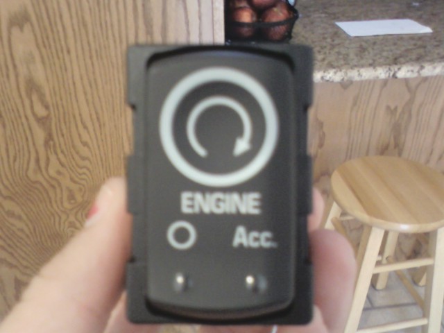

Posted: November 12, 2008 at 8:08 AM / IP Logged
Just one of the front of it.
08 corvette ignition switch pinout -- posted image.
The back of is laid out like I put the numbers, with the number representing the pins.

Posted: November 12, 2008 at 8:14 AM / IP Logged
How many lights does the switch have?  Can you take it apart?

Posted: November 12, 2008 at 8:28 AM / IP Logged
I'm guessing 3 at the most. I was hoping someone would/could come up with a pinout/wiring diagram for this thing so I wouldnt have to take it apart but it looks like I will be taking it apart now. I THINK it has three lights. One for the start portion and two for the off and ACC.

Posted: November 12, 2008 at 10:37 AM / IP Logged
so three LEDs and two switches?
I would guess that the LEDs have a common + and individual - triggers.
I would also guess that the switch sides switch a - signal.  I'm not sure what the other pins would be for.  Is there continuity between any of the other pins besides the two you already identified?
