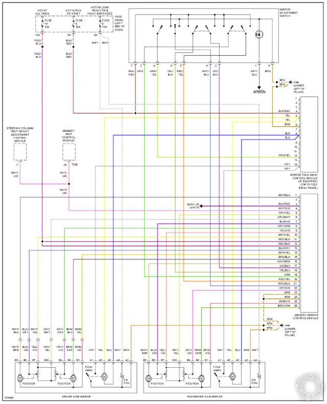

there is a control module but I can't tell how it works without doing some test. here's the diagram, it should point you in the right direction.
audi power folding mirrors -- posted image.
pm me your email address & i can send you a pdf of this

A few more coments about Audi CAN systems. Installed a DVD player in an 06 Toureg,  removed to install (last year or so) in an 07 A5. Had to order a different CAN converter because in that 2 years they'd changed the operating protocols, hence what works for an 04 may not work for an 07.
My rules on ALL German cars after about 03 are if you HAVE to work on them, don't turn on ignition with anything disconnected, go to the outputs, e.g. fuse boxes or actual motors, everything inside the car is probably data. Do get a wiring diagramme.
Remember even late 90s Golf/Jetta/Passats, you had to go into the driver's door to do the locking.
Ref Audi, eg A4/56 take the driver's door; 4 window switches, lock switch, mirrors, speakers. Going in to the door, constant pos, ignition pos, ground, speakers wires and two pairs of CAN wires. I rest my case.
Further DEI launched CAN1 or CANVW specifically for these cars. It doesn't seem to work on half of them.
