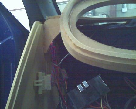

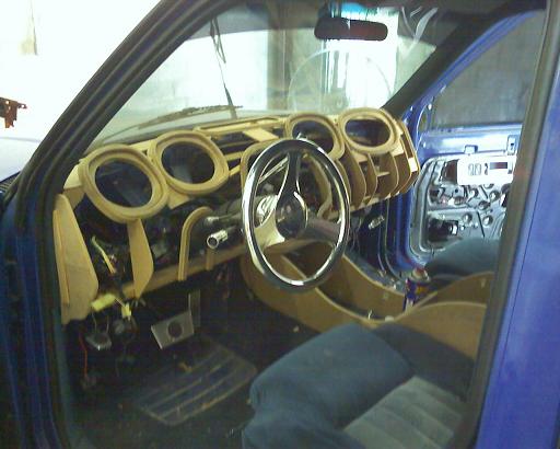

here we go guys. first step take out the old dash!! duh. keep it around so you can trace the part that come's in contact with the dash. makes life so much easier. now set that in place. no make your end caps. if your useing the factory door panel trace out the side of the dash so have a perfect line up to the factory doors. this makes it look that much better. in this picture i've already made those Gay 6x9 rings flush mounted of course. once you have your end caps cut and routered out get in the ride and close the door, screw these peices to the inside of the truck and make sure they line up with the door when it's closed. if you lok close i took a peice of 1/4 inch mdf to space it away from the door so it is not touching the door but comes very close. you do not want it to touch. once your all screwed in attach your top plate to your side plates. as in this picture.

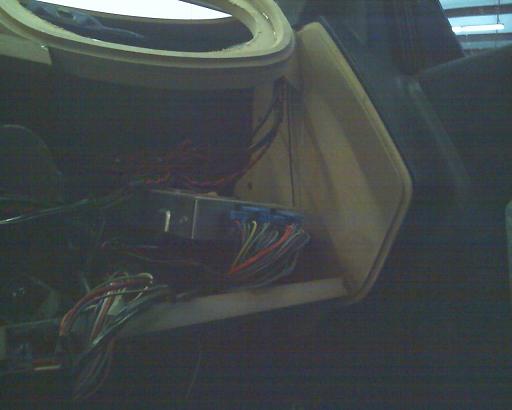

this picture show's how close my end caps are,

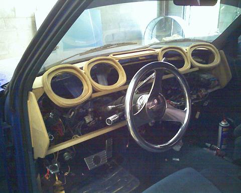

ok in this picture i've alreadystared the console and added most of my bracing, these braces alow me to get an idea of how the dash shape is going to look before i even wrap it in fleece.
Fiberglass Dashes - Page 2 -- posted image.
notice where the console meets the dash, i've made to pieces exactly the same size and screwed thm together. top one is set in to place attached to the dash and the bottom to the console this will allow me to have a perfect match up between the console and dash in the end. you'll see more of this as we go on. the big opening in the middle is routered out to accecpt and peice of plexi that will be back lit. and also house the digital gauges nd double din radio.
