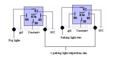

I am still having problems the lights dont flash with that purple arming output like alpine says it should. Anybody know if there is something you have to set on the alarm? My other idea is to use the parking light +10 volt output that already flashes my lights when I turn my alarm on and off. But if I tap that line my fog lamps would come on with my parking lights which I don't want. I have thought to use a diode but I do not know which one to use or how to wire it in to the relay. Any ideas about the Diode to use and where to get one?

I am guessing that my output is a very quick and the relay is to slow to detect the pulse without using a latching relay is there any thing i can use to make the -200ma output to last any longer or should i give up and tap into the dome light surveillance output and hope that i do not blow another fuse again. Please any ideas.

How about this?Fog Light Flash -- posted image.
bhawkins
Member - Posts: 31
Joined: March 15, 2003
Posted: March 16, 2003 at 7:55 PM / IP Logged
Thank You I will try that.

yea i was gonna say whats wrong with putting a relay on the parking lights wire?

Thank you all for your responces the foglights are made by pilot and they have a built in city light bulb that are made to be plugged into the parking lights.
Thank you everyone!!!! Fog Light Flash -- posted image.
