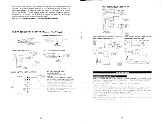

As far as I know, the car has the "2 Step Door Unlock Wire Connection for Ground Switched Door Locks". I hooked the Autopage H10/14 Pink Wire up to the ORANGE / Black wire for the door unlock right before it connects to the computer. I also did the same with the Autopage H7 Green Wire to the RED / Black door unlock wire. The doors all lock and unlock, but they do not unlock in two stages. I am trying to figure out where the Autopage H7 Blue Wire is supposed to connect, and I think it's to a wire that goes to slot 86 in a relay behind the glove compartment that. When this relay is disconnected, the drivers door neither locks nor unlocks. Also, slots 87 and 85 on this relay read +12V on my multimeter. Can anyone tell me if this is in fact where the Autopage H7 Blue Wire is supposed to connect? Also, where is the wire I am supposed to cut?
Hopefully someone can answer this soon so that I can finish getting everything installed and get the car put back together. I'm sure I will have more questions as well, but this is most important right now.
