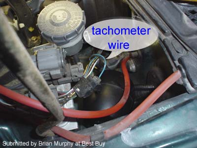

tach signal, 96 integra -- posted image.
Well you are not getting the proper reading at the module. You don't mention what you have tach connected to in the car. It should be a blue wire and you get it at the test tach connector. This is a 2 pin connector located in the drivers side rear corner of the engine compartment....

Tach wire well never give you that voltage, set your metwer to AC volts and you should get a reading of about 3 volts increasing slightly as you rev up. Mike showed you the correct place from which to get it. Alternates would be back of rev counter (tacho) or one of the non common wires at one of the injector ports.
