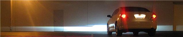

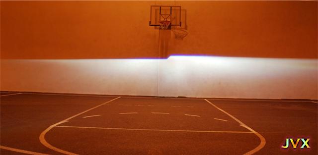

The pictures below show how your beam pattern with HIDs properly installed should look. (These are borrwed from hidplanet, but not hotlinked.)
are your headlights legal? -- posted image.
The reason for this is because it illuminates signs properly, as well as projecting the light miles down the road, but the step in the middle also keeps the light out of oncoming drivers eyes.
You can see from the picture on the bottom that it projects light low, far ahead of you down the road where it's actually needed, instead of just pouring light into every available open space.
When you switch on your high beams, the shield creating that nice little step, and crisp clean line, drops down and allows more light through.

I'm wondering how far from the wall the car is on that top picture? I guaranteeee you that those lights will burn your retinas.

E-codes are illegal in the US (legal in canada) mexican headlights are illegal (sorry, bora conversions) bulb replacing kits are illegal, and retrofitting tsx/rsx/etc projectors into something else is also illegal. So is modding the light pattern, as was done above.
