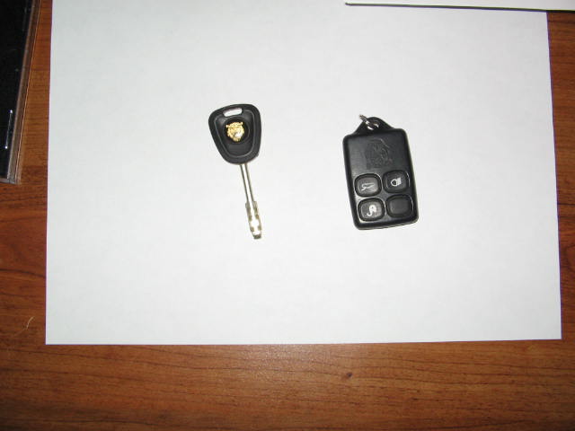

remote starter for 2000 xj8 -- posted image.

Iv'e posted a pic of the key for the ign and the door fob, as shown its like the same type key we use in our 80's Jags theres no chip in it , I've actually had old NOS keys made for the 2000 and theyv work fine, so If the car is picking up signal what would I look for , man I'm fustrated It should be in no sweat, and its gonna be -15 out yikes!
