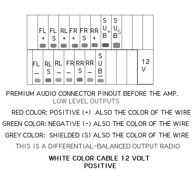

Interesting question here In my 08 accord coupe I have wired the system up, and it does work... my issue is a lot of noise (hiss) stemmed from the OEM amplifier.. My understanding is that the system from Honda is a balanced output system... Does anyone Know the wiring setup from the low level inputs going INTO   the amplifier?
I know the colors are like Grays greens and reds and a white wire as well... the damn noise is really beginning to "tweak my mellons" for lack of a better word!   LOL! Cant say what I want to really say.. ;)   Also, Im running an Audio control LC6I to process the signal.... My understanding is that the LC6 sould be able to read and convert the balanced low level signal....
Any help would Be massively appreciated...   Spring Break Nationals is coming soon!

I found this online, But im still skeptical as to whether or not it will work, and how accurate it is....
2008 accord cpe exl audio wiring ? -- posted image.
