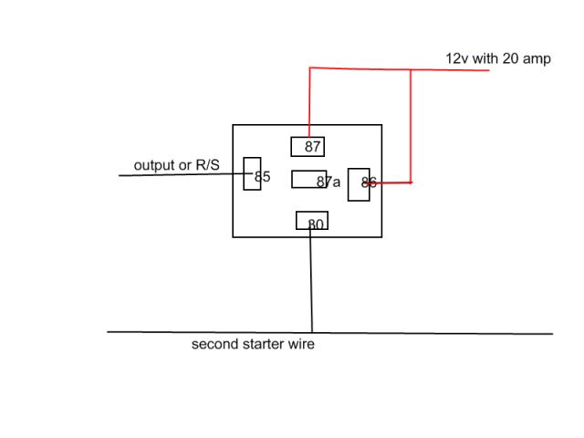

according to my installation guides
you have to have an output from the R/S, set for starter,
96 240sx remote start -- posted image.

what color is the second strt wire. now does that wire only need to be powered when starting? or does it need to be on when ignition is on.

it is BLACK/ white and needs to be powered just as the primary start wire, not all the time like an ignition wire.
