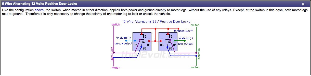

The Spal kit has a control relay but there are not any inputs on it for a keyless entry system. The 712t has a built in relay on it. If i were to cut the purple, brown and green wires from the actuators would the 712t act as a central lock control with manual lock operation? If i cut them, how then would i wire them to the 712t, would i need additional relays?

I think this is what i am looking for but i am not positive!

I was showing the picture of the relays to represent the built in relays on the 712t and not in addition to it. I apologize for the confusion, as i am new to this side of electronics. Let me try and explain more clearly the entire set up so that i make sure that i understand you correctly. The Spal power lock kit consists of 2 5 wire actuators with red, blue, purple, brown and black wires and it has a control unit So if i understand you correctly i will install the Spal kit with the supplied control relay, then splice the green lock and blue unlock wires from the 712t to the blue and red wires on the Spal harness near the control relay and ground the two #87 N.O. inputs. Then i will only hook up the red and blue wires on the passenger actuator to the control relay. Sorry to be a bother but i just want to make sure that i understand you correctly and i really appreciate you taking the time to explain this to me!

The brown and purple are the leads that you are looking for they are the neg lock/unlock switching wires just connect to blue/black and GREEN/ black from the 712 set to neg output. It seems that you have the Italian made kit, there should be 2 tails at the relay end, with brown and purple, if not join at the relay. The blue and reds going to the motors are MOTOR WIRES,  don't join your 712 to them and STOP thinking about relays.
